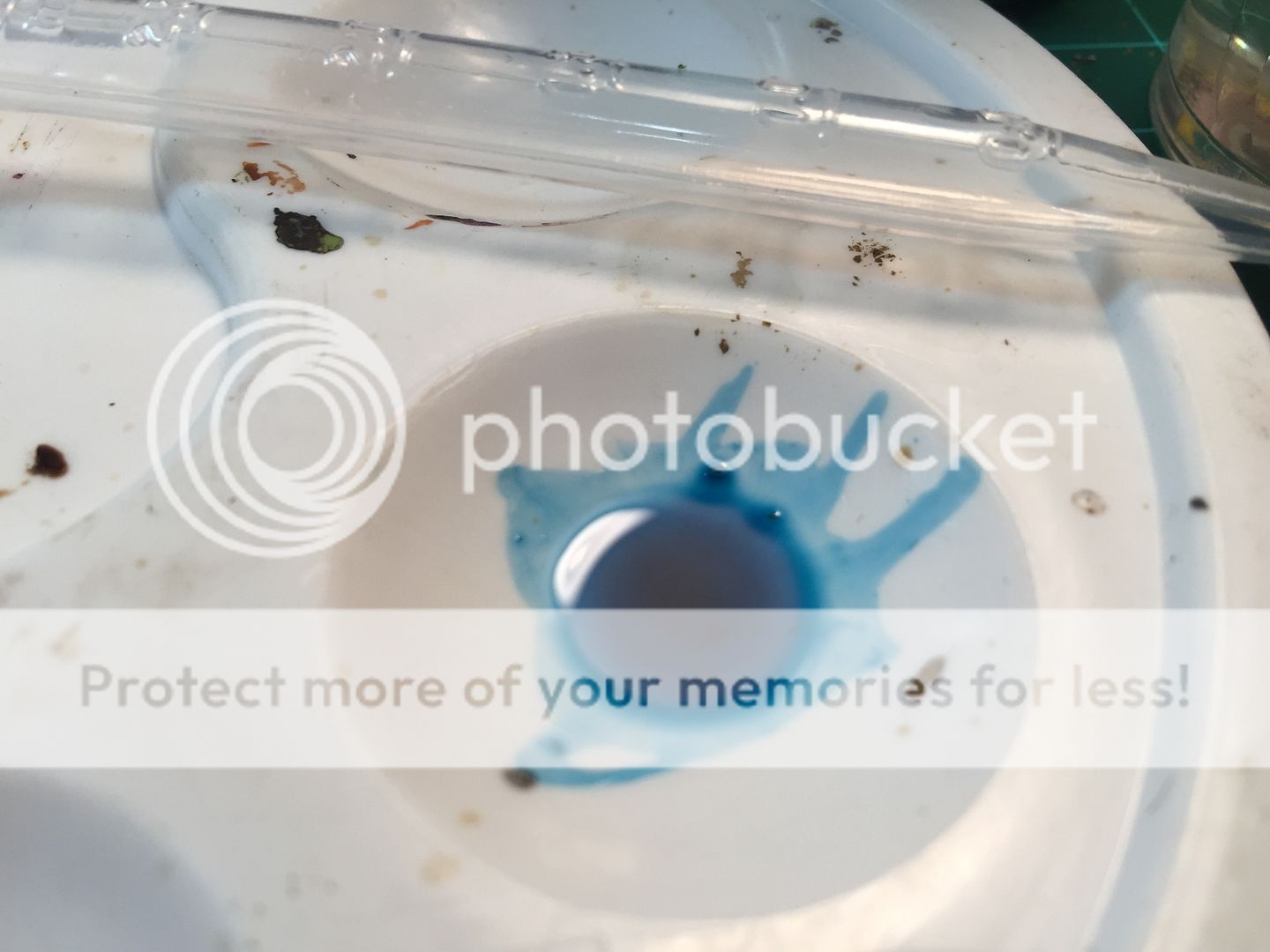

Post by Oldent » Mon May 15, 2017 8:53 am
Harneloot wrote:
Mon May 15, 2017 7:04 am
OK, thanks Biowizard!
I am using the Freak Flex transparent Teal paint film as suggested by Unclebilly. Any idea how what the ratio of water to paint drops should be? More than 1:1 I am guessing?
I have not used Freak Flex transparent paint so I am hesitant to recommend a ratio. I recommend adding a very small amount of water at a time, too much will ruin the paint. I use a water color plate and a eyedropper until I get it right. Wash the tile with dish soap first. You are trying to add color to a clear plastic/PVC tile.A paint wash is usually used over paint.
To make your own wash with with Dwarven Forge brand paint use floor wax as the thinner.
This will cover unprimed plastic.One drop Pledge one drop paint.
